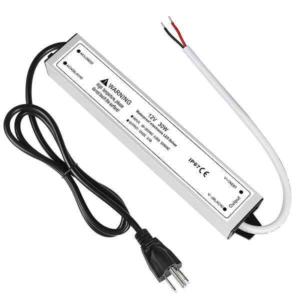

If the installation environment requires waterproof protection, we recommend the following waterproof power supply:

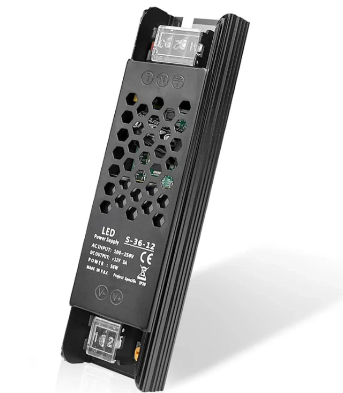

If waterproof protection is not required, such as for indoor or dry-location installation, you may choose the following non-waterproof slim switching power supply:
