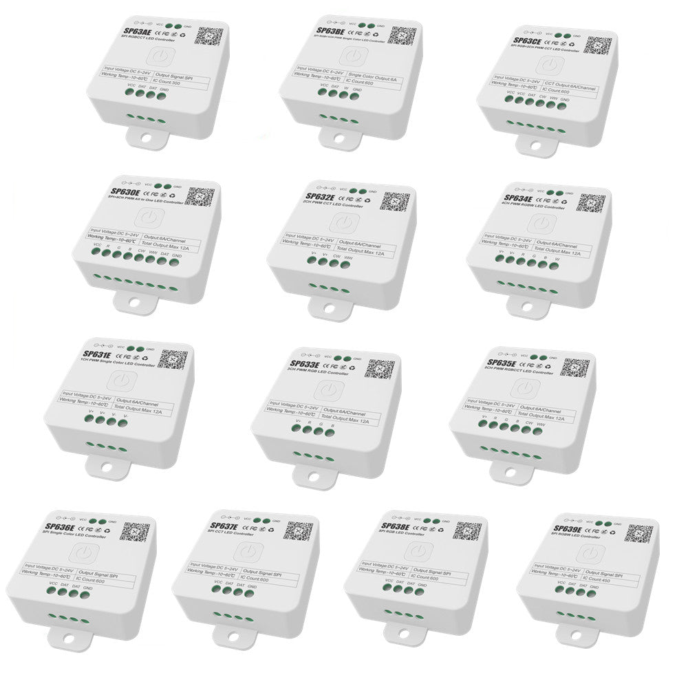

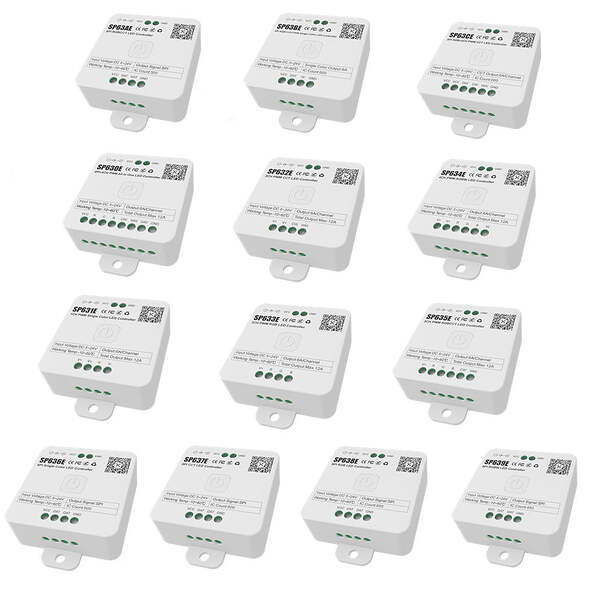

For these 12V RGBW downlights, you can use a compatible RGBW PWM controller like this one:
The controller supports RGBW lighting and app control.
If you are using a separate power supply, both the controller and power supply should be rated higher than the total wattage of your lights. It’s generally recommended to leave around 20% extra capacity for more stable performance and longer lifespan.
