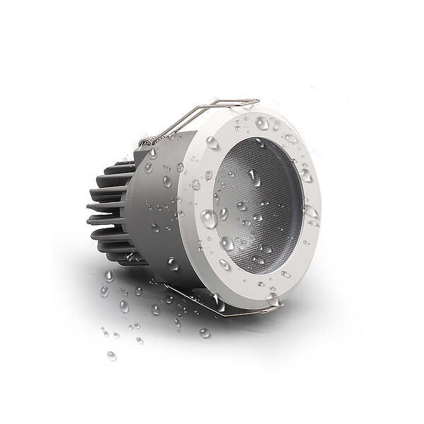

I’m looking at the FX-1 Series waterproof LED downlight, which is rated for 100–240V AC input.
If I already have a main 12V power supply from a transformer, is it possible to cut off or bypass the built-in transformer/driver in the light and power it directly with 12V?

The driver is fully integrated inside the fixture and designed to work directly with 100–240V AC input.
There is no external driver or transformer, and the internal driver is matched to the LED chips, so it cannot be removed or replaced with an external one.

This model is designed to operate on 100–240V AC input and includes a built-in LED driver inside the fixture.
Because of this, it cannot be powered directly by a 12V supply, and the internal driver cannot be bypassed safely.
If you connect 12V directly to this light, it will not function properly and may cause damage.
If your system is based on 12V DC power, you’ll need LED lights that are specifically rated for 12V input, such as low-voltage step lights or landscape lights designed for DC 12V operation.
