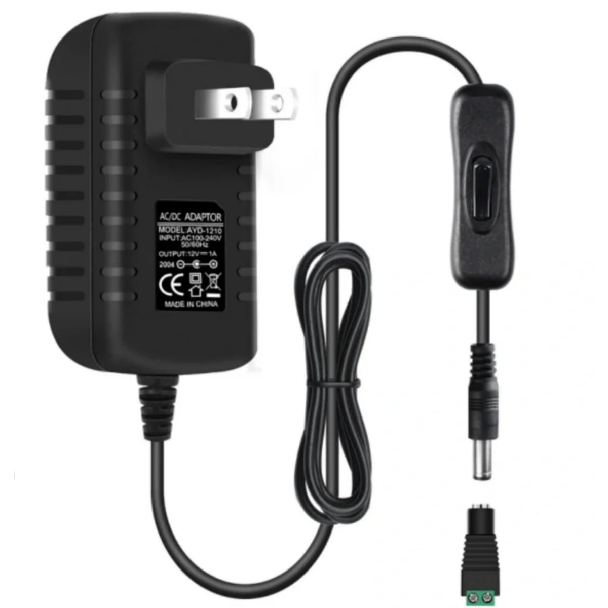

Based on these two products, the following DC12V power supply adapter can be used:
You can choose the 12W / 24W / 36W option depending on how many strips you plan to power. For example, one strip can be tested with the 12W option, while multiple strips may require a higher wattage option.
